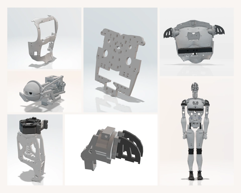

Humanoid CAD Design:
The robot components were modeled with a strong focus on biomimetic proportions and mechanical realism.
Complex curved surfaces and structural detailing were incorporated to replicate the appearance and movement of a humanoid system.
Lattice structures were integrated into selected regions of the robot components to reduce weight while enhancing the futuristic visual appearance of the robot.

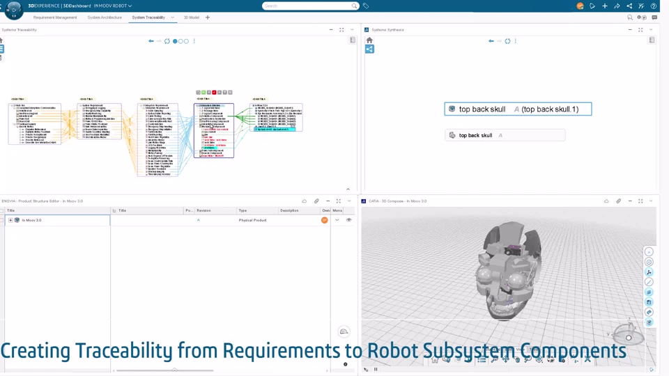

During the CAD development process in CATIA, reference planes and partitioning techniques were used to isolate functional regions for lattice application and component optimization.
Variable wall thicknesses and reinforced joint regions were implemented to improve durability while maintaining smooth surface transitions and refined aesthetics.
CAD Assembly:

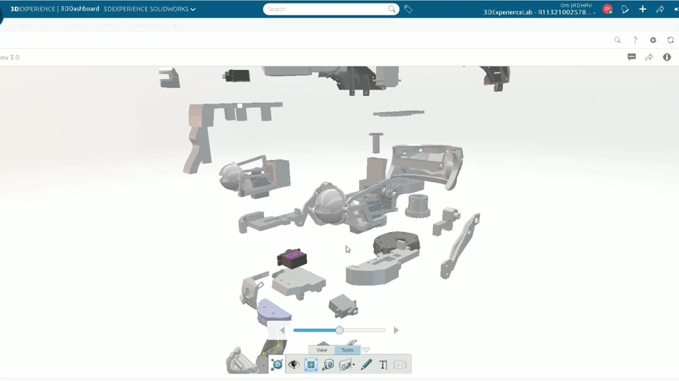

A full digital assembly of the humanoid robot was created to validate fitment, joint alignment, and component interaction before manufacturing.
The assembly process included the integration of servo mounting systems, joint mechanisms, structural brackets, and electronic housing sections.
Motion clearances and articulation ranges were analyzed digitally to ensure smooth movement across the robot’s neck, arms, hands, and torso mechanisms.
Exploded assembly views and hierarchical component structures were developed to streamline manufacturing and physical assembly processes.

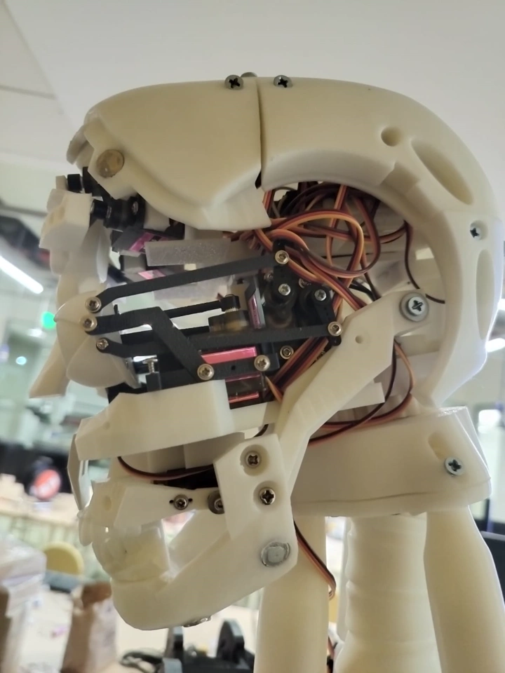

Assembly of all 3D Printed Parts:

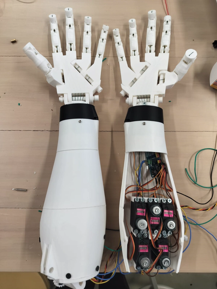

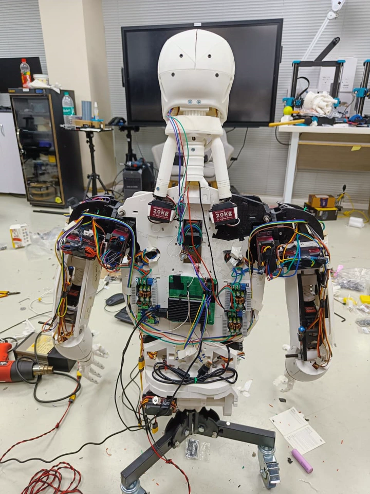

All 3D printed components were assembled into a complete humanoid robotic platform through a multi-stage integration process.
Servo motors, wiring harnesses, fasteners, bearings, and structural supports were installed and calibrated to ensure accurate motion and stable operation.
Joint calibration and positional tuning were performed to achieve smoother articulation and synchronized movement across multiple degrees of freedom.

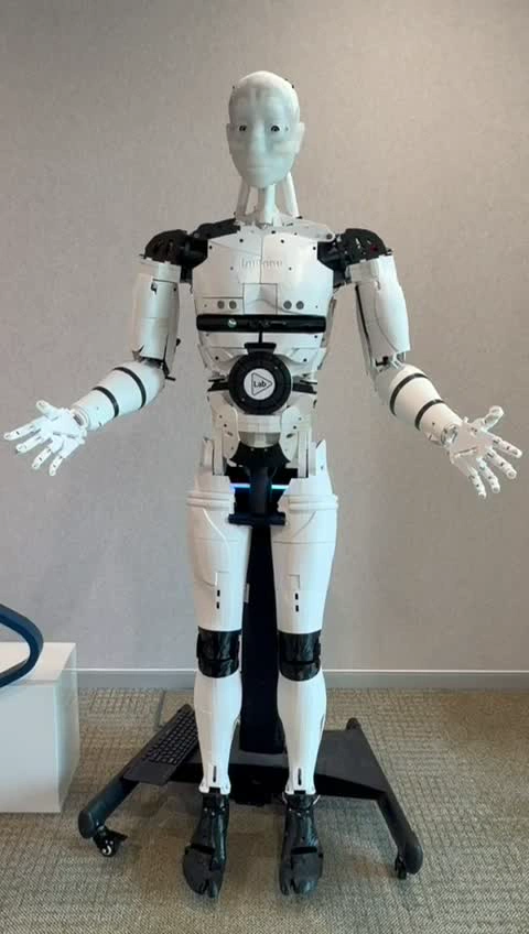

The final assembly combined mechanical precision, embedded electronics, and digital manufacturing into a fully integrated humanoid robotic system.

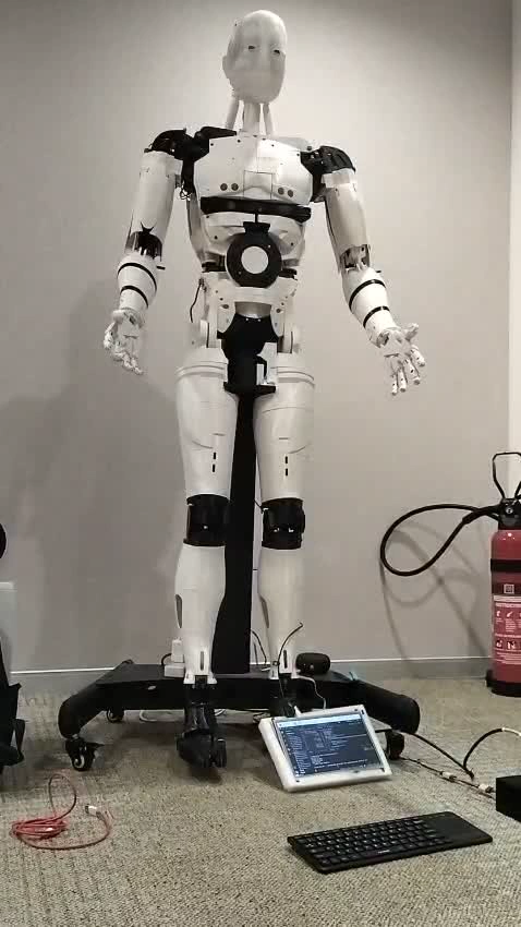

FINAL TESTING:
FINAL RESUT:
