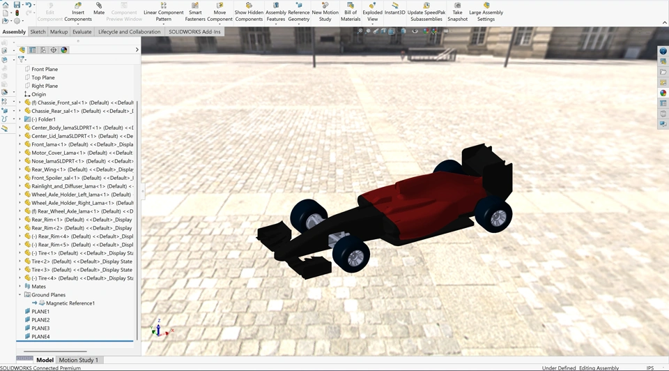

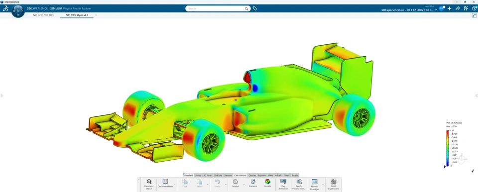

The RC F1 car was assembled in SOLIDWORKS Connected. Our model was designed off of the Open RC project. We further developed it by modeling several different rear wings and modified several internal components. 3DEXPERIENCE SOLIDWORKS allowed us to work together efficiently, even when we were not in the same room.

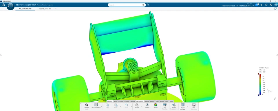

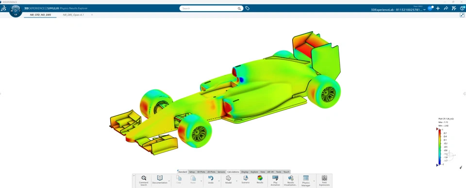

The images above show two assemblies, one with DRS open and one with DRS closed, modeled for the pressure coefficient when moving forward at around 26mph. Red indicates positive pressure (pushing force) and blue indicates negative pressure (pulling force). In Fig. 4 (DRS closed), the top of the wing is almost entirely red, with a small area of blue underneath (Fig. 5). By contrast, Fig. 6 (DRS open) shows very little red, meaning less air pressure on the rear wing. The simulations predict that with DRS open, there is reduced pressure and therefore less drag which allows the car to reach higher speeds.

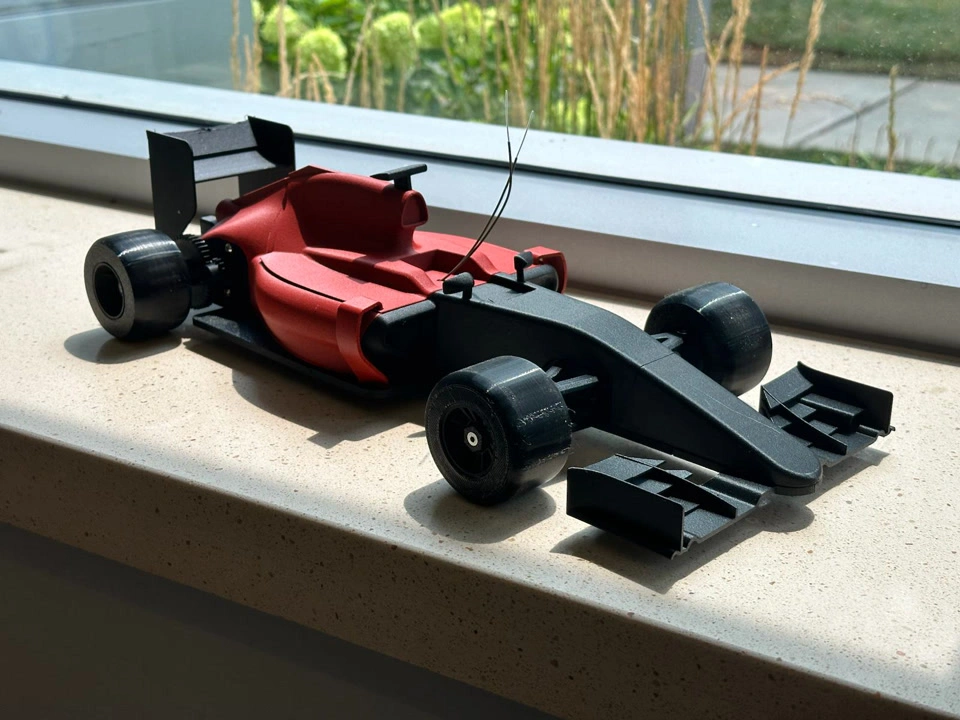

The entire car was 3D printed, except for just a few components. The top of the car and the chassis were printed with PETG-CF filament from Bambu on a Bambu X1C printer. Even the tires were printed using a TPU filament. To gather telemetry data from the car, we used two ESP32 Arduino Nano boards, an IMU (MPU-6050), and a Hall effect sensor. The combination of these sensors yielded an onboard telemetry system.
ESP32 Arduino Nano - This was our chosen microcontroller. The board has a built-in wifi protocol to send data in real-time up to 100 meters. We used two of these boards, one as a transmitter located in the car and one stationary board connected to our computer.
IMU - Inertial measurement unit. We used one IMU sensor to record G-Force data.
Hall Effect sensor - We incorporated a hall effect sensor and a small magnet located on a gear connected to the car's motor to record the car's speed

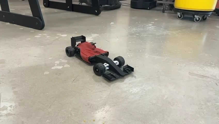

Now for the fun part! We took the car out on a sunny day with one goal in mind, go as fast as possible. We ran a few laps with each rear wing configuration, DRS opened and DRS closed. After recording the data using the embedded system, we saw that there was a 4.77% increase in speed when DRS was enabled going from 27.23 mph to 28.53 mph. This correlates with the on average improvement in speed of 5% as a result of DRS that actual F1 cars experience, which is exactly what we wanted to see!
