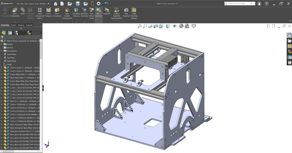

Structural Approach: Hybrid Construction
The build employs a hybrid construction method that balances strength, weight, and manufacturability:
Aluminum Framework:
  • 1/8" and 1/4" 6061 aluminum plate, primarily laser cut
  • Plates connected with standoffs and tapped mounting points
  • Secondary operations (countersinking, tapping) are done in-house to manage costs

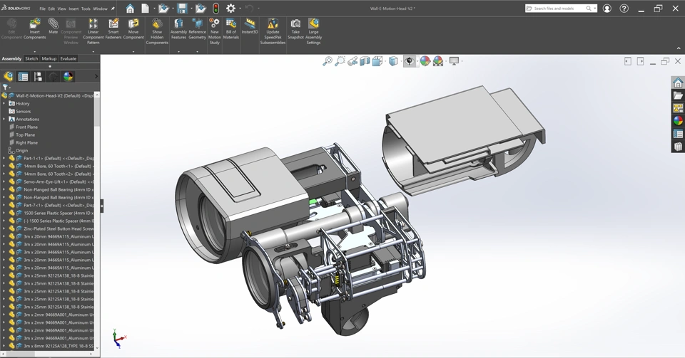

Custom CNC Parts: The most significant design decision was investing in custom CNC components for critical mechanisms, particularly in the head and neck assemblies. Rather than using off-the-shelf brackets, spacers, and adapters, I designed integrated parts that eliminate hardware and reduce part count.
For example, the head tilt mechanism uses a single custom bearing plate that integrates mounting surfaces, bearing seats, and structural elements that would otherwise require multiple stacked components and dozens of additional fasteners. This approach is more expensive upfront, but results in lighter weight, better alignment, fewer failure points, and significantly simplified assembly.
Neck Mechanism: Three-Axis Motion System
The neck assembly demonstrates the integration of custom parts with commercial components:
  • Pan/Rotation: Base-mounted motor provides 360° rotation capability
  • Linear Extension: Commercial linear actuator provides vertical neck extension/retraction, one of Wall-E's most characteristic movements
  • Head Tilt: Custom CNC'd bearing plate at the top enables head pitch articulation
This three-axis system recreates Wall-E's full range of expressive head movements while maintaining a compact package that interfaces cleanly with both the body chassis below and the head assembly above.

Completed:
  • Main body chassis (aluminum framework with mounting points for all subsystems)
  • Head and neck mechanism (full range of motion validated)

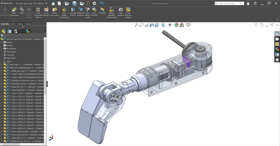

In Progress:
  • Arm assemblies (currently prepping parts for assembly)
  • Arms are primarily 3D printed; future revision may incorporate a lightweight metal chassis for improved rigidity
