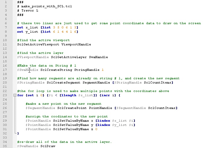

SclGetActiveViewport
SclGetActiveViewport      ViewportHandle
This function will create a TCL variable which contains the unique name of the viewport. In this case the variable is called “ViewportHandle” but you can use anything you like here, as long it is valid as the name of a variable in TCL.
SclGetActiveLayer
\\\$ViewportHandle     SclGetActiveLayer     SwaHandle
This function needs the name of the viewport for its query so we will pass it the name of the viewport using the variable name we made in SclGetActiveViewport. It will make another new variable for us, this time called “SwaHandle”
SclCreateString
\\\$SwaHandle     SclCreateString     StringHandle 4
This function will create another variable, “StringHandle” and requires us to specify the layer that the string is meant to exist in, as well as the layer and string number that we will assign to the points. This needs to be a positive integer, here I’m using string # 4.
SclCreateSegment
\\\$StringHandle     SclCreateSegment     SegmentHandle     0

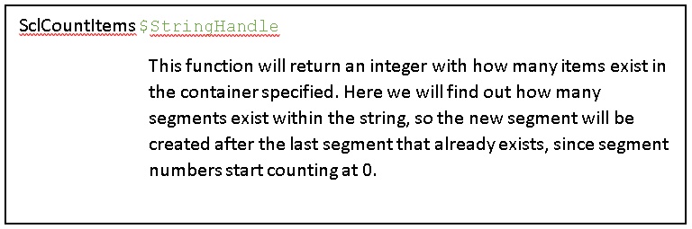

Here’s where things get fun. The syntax here is identical to SclCreateString where we create another new variable called “SegmentHandle” and an argument that specifies the segment number, here I’ve used segment # 0. However, a problem arises if string 4 segment 0 already exists in the graphics workspace. To get around this I use another SCL command SclCountItems.

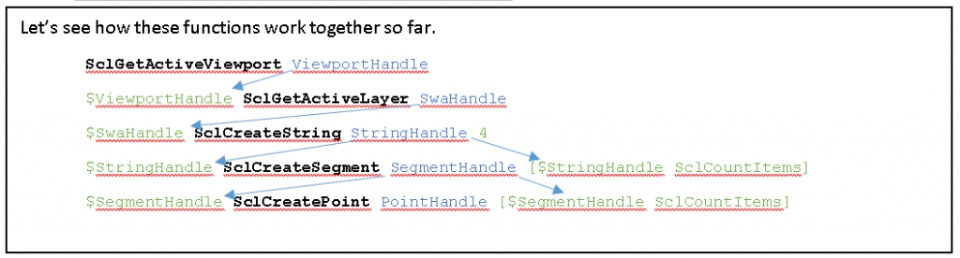

Combining these two functions gives us:
\\\$StringHandle     SclCreateSegment     SegmentHandle     [\\\$StringHandle     SclCountItems]
SclCreatePoint
\\\$SegmentHandle     SclCreatePoint     PointHandle     [\\\$SegmentHandle SclCountItems]
The syntax here follows the same as SclCreateSegment and we can also use SclCountItems here too.
The points will now actually exist, and could be drawn to the graphics workspace, however their coordinates will at a default at the origin (0,0,0) in the graphics workspace. To give them some meaningful coordinates we need our next command
SclSetValueByName
\\\$PointHandle     SclSetValueByName     x     \\\$x_coordinate
\\\$PointHandle     SclSetValueByName     y     \\\$y_coordinate
\\\$PointHandle     SclSetValueByName     z     \\\$z_coordinate
When making new points, SclSetValueByName is typically used three times, to specify all three coordinates for the new point. Optionally you can also set d-fields with SclSetValueByName.
\\\$PointHandle     SclSetValueByName     d1     “d1_value_goes_here”
\\\$PointHandle     SclSetValueByName     d2     123.456
SclDraw
\\\$SwaHandle     SclDraw
The final thing we need to do is to tell Surpac to draw the new points on the screen. This can be done at any level of the hierarchy below Viewport, but I typically save the action of drawing, until I’m done making all of the contributions to the layer, and I will draw everything at once.
Let’s combine these functions into a simple example.
