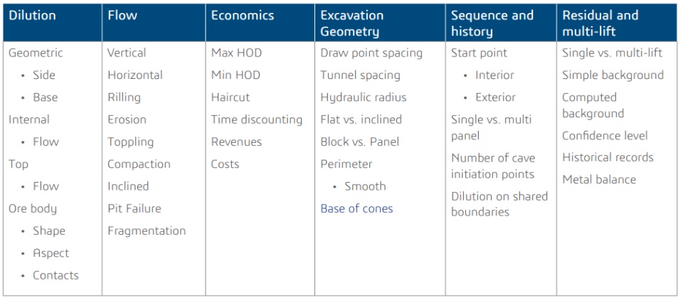

SUMMARY
A concise summary of the above factors has been put into Table 2 to provide a check list of factors to consider during a block cave evaluation.
