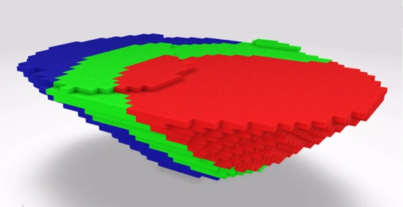

A unified design environment, like the 3DEXPERIENCE platform we use, is organised around parametric design. In this type of design, all inputs and outputs are stored as parameters. For pit optimisation, for example, these parameters include the pit wall slope angle, bench height, metal content, mineral prices, processing costs, scheduling and geotechnical considerations, and so on. More than that, however, the parameters could also be 3D objects, such as pit shells, or even other parameters or formulas.
This parametric organisation in turn compels a linear association or dependency between upstream and downstream tasks, where a change made anywhere by anyone within the unified design environment can (either automatically or by the click of a button) be updated across the workflow and either produce a new optimisation or update an existing one.
In other words, with parametric design, the pit design is aware of the pit shell. If the pit shell is updated, a quick re-run of the pit design will ensure all parameters, including the pit shell change, are applied. In this way, the inputs of each step of the optimisation will actually be the outputs from the prior step.

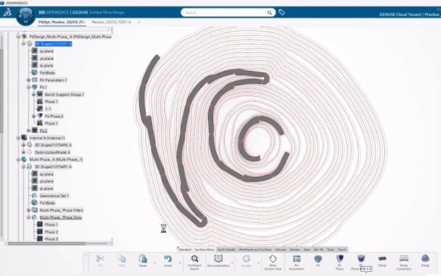

If I’m a planning engineer and I want, say, to generate toes and crests for specific mine designs using GEOVIA Surface Mine Designer, the workflow is more or less as follows.
I first choose a pit shell to which the design should conform, then apply certain parameters, like bench height, berm width, projection angle, etc. I then decide whether I want some (or all) changes, like bench height or angle, to be updated automatically, in which case the design will update itself as soon as I hit okay, or whether I want to make some (or all) changes manually.
If I make that second choice, any non-automatic changes will accumulate until I press the go button. This is particularly helpful if you are making lots of little changes and don’t want the design to update itself every single time: it’s up to you to determine when you are ready to see the cumulative effect of all the changes.
When I decide I’d like to to compare one design scenario to another, I can then drop it into a process composer simulation. Let’s say I want to see what happens to the design if the nickel price per pound changes.
First, I decide how I want that input/parameter to change and how many iterations I want to run: for example, to go up or down by 25 cents in value and to complete 100 iterations. The optimiser will then change that input as specified, execute the workflow with 100 incremental changes, collate the results, and present them to me for analysis at the end. I can compare the design scenarios and select the one that best helps me in my hunt for the optimal pit shape and mining sequence.
