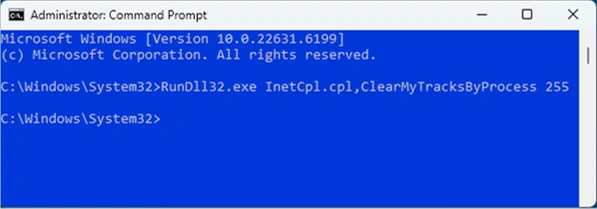

  1. Clear your tracks by process
    1. Start | Command Prompt | Run as administrator
    2. At the command prompt, input this string RunDll32.exe InetCpl.cpl,ClearMyTracksByProcess 255 and press ENTER
