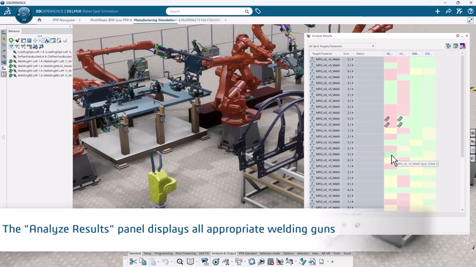

With r2026x FD02 we delivered multiple improvements in the tool search functionality.
Value :
Tool search functionality has been completely redesigned to Increase user efficiency in finding the appropriate spot welding tools.
Highlights :
Enhancement of the result panel by adding column displaying the count of success versus total
Multi-Clearance and gun tip abrasion support
Provide an option to sort and filter fastener (by name, type, diameter and children’s fastener)
Generate a web report of the search analysis results
Persistent save of tool orientation in a dedicated trajectory for future reuse.
Here is a short video showing these new capabilities :
