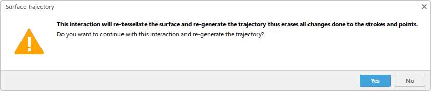

  • If you then modify the Stroke Spacing, then you are forcing the Surface Trajectory to recompute and you will lose the inserted/modified (locked) targets
    • This message will get displayed:

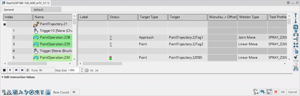

When in Teach
  • You can use the context menu to Copy the Robot Motion (PaintOperation.[x])
  • Then move the target of the copied Robot Motion with the Robot Manipulator
  • Then select Modify Current Target?
You can copy/paste and move a Tag from the Spec Tree into the Surface Trajectory and then create a Surface Task that will include a Robot Motion (PaintOperation.[x])
