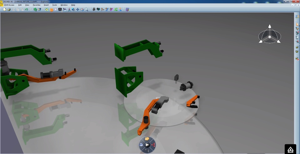

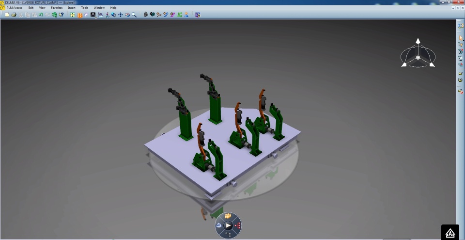

What is Mechanical Device Builder (MDB)? - Mechanical Device Builder/Device Building is a solution for modeling the mechanical systems that are typically used in the manufacturing process.

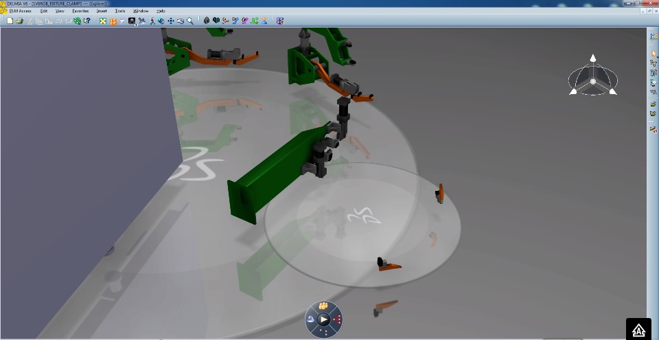

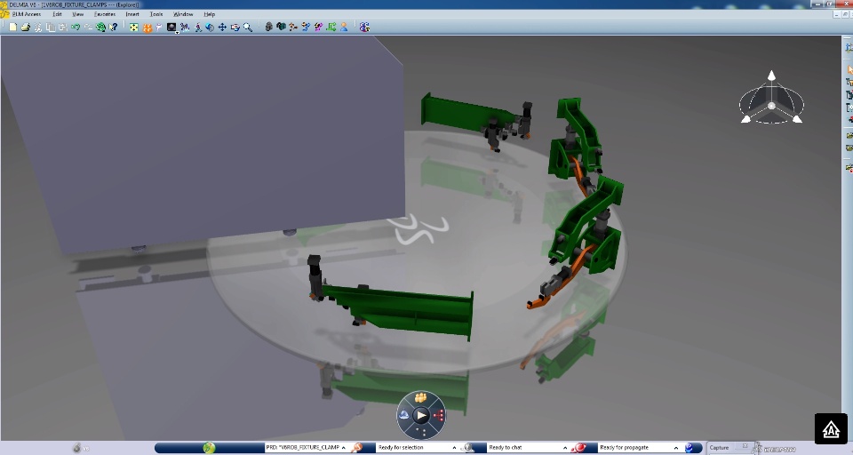

 Wizard Functions: Kinematic Builder and Device Builder commands are seen on selecting the arrow along the edge of “West: Shape & Representation” in Compass. Like ‘Wizards’ these commands brings down the complexity and pain of defining the kinematics and help building a device very quickly. On selection of each command set of tools and commands opens up and helps user to define kinematics or build devices in a very intuitive and faster way. With the integration of multiple functions/commands in the single bundle, user need not think for the required pre-requisites as the same can be  done on the fly using these wizards. Thanks to the DS R&D (DELMIA) team to bring such a useful tool for the user.
How to do? (The video has been taken while building the fixture device in V6R2013) – Refer the video showing the steps in building the fixture kinematic device.

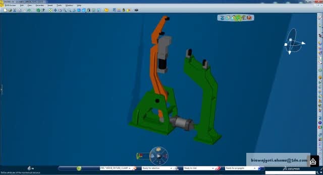

Pic: Exploring the device assembly.
