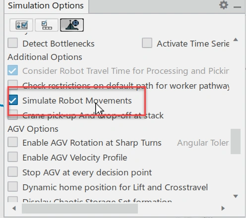

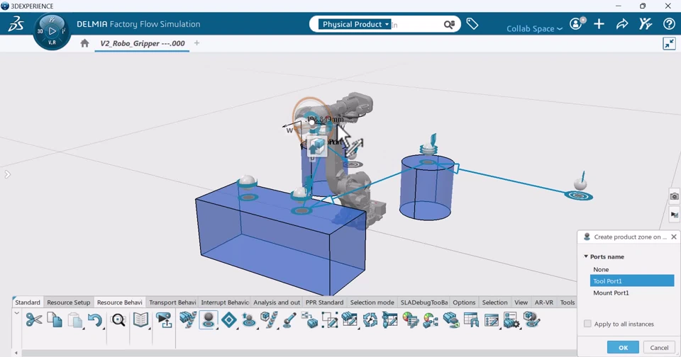

From R2026xFD02, user can now animate Robot movement in Factory Flow simulation while performing task using the simulation option "Simulate Robot Movements".
Highlight
Select Simulate Robot Movements in the Simulation Options panel, then simulation will inherit of the robot movements defined in Robotics role.
