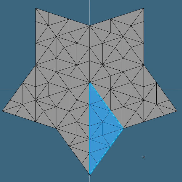

2 years ago, I made a try with a Penrose tiling. I kept bothered because the modeling was too complex and impossible to explain. I posted it anyway for the result only. Here is a reboot of the study, with a much better visual scripting app, no "user defined" feature and my better understanding of the logic for a short modeling. I was able to go a little further, up to P3, which is the rhombus tiling. but this will be for another post.
overall size of the current modeling -> I think it is short

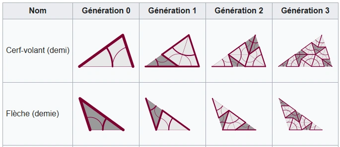

About the math behind, the French version of wikipedia gives more details than the English one.
here is what I found important for the modeling.

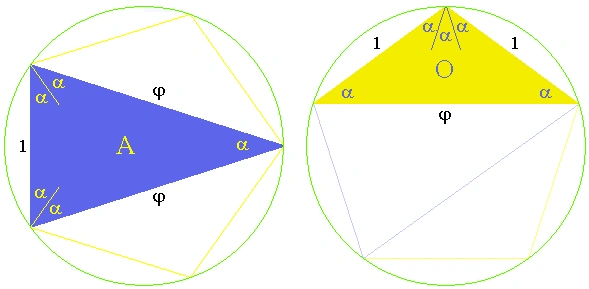

the kite and dart tiling is made of 2 types of tiles. they are golden triangles
the subdivision rules are as below.

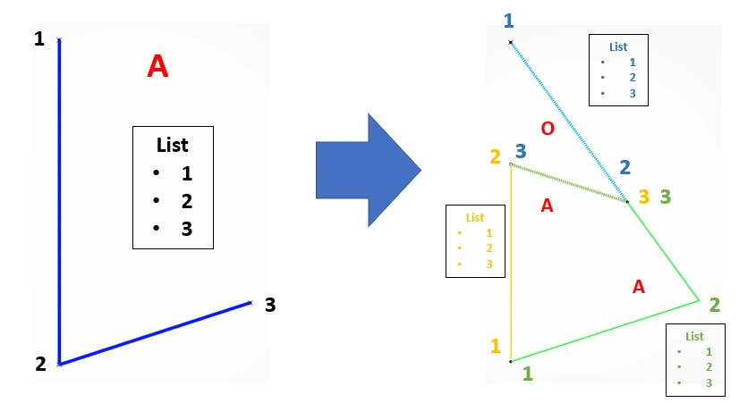

  • triangle A (angle aigu)  will transform into 2 smaller triangle A and 1 triangle O.

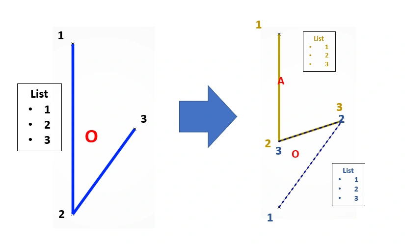

  • triangle O (angle obtus) will transform into 1 smaller triangle A and 1 triangle O
also, the transformation is oriented breaking the symmetry of the triangles.
This took me long time to catch, because I was just looking at triangles while it should have been the 2 different edges of the triangles. Like below picture, there is a meaning to the thick edges
For the modeling, I decided to use the 3 vertices of the triangles on a defined order.
Here is the transformation from Generation 0 and Generation1 for triangle A
And here is the transformation from Generation 0 and Generation1 for triangle O
They will be used to make the triangles later on.

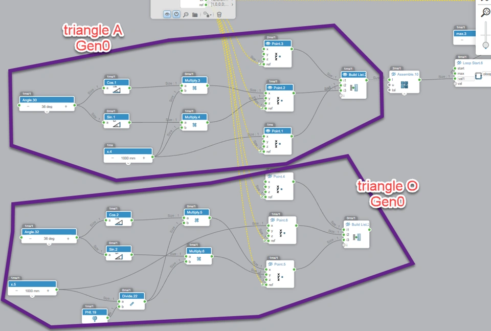

Modeling steps
1. make Generation 0 triangle A
  1. the last "build list" is made of the 3 triangle vertices on the order explained above.
  2. I assembled it in order to have 1 feature input for the loop -> no need deepening
  3. in the picture, I left the triangle O as well. but not used
2. start loop and create path for triangle A transformation
3. create path for triangle O transformation
to be easier change input to triangle O generation 0
4. group all the required points into "build lists" to make the transformed triangles as explained in the logic
then you need a condition depending on the type of the triangle to be transformed.
5 finish the loop and use the outputs in order to make the triangles
This mesh is ready for many variations. I will make a post later on the variations. next one is Rhombus type
