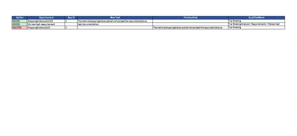

  3. Report with changes is generated automatically. Flow was first validated using MCP for CATIA Magic and Polarion, then automated using GitLab MCP.

  • CI CD ready requirement synchronization between model and ALM.
