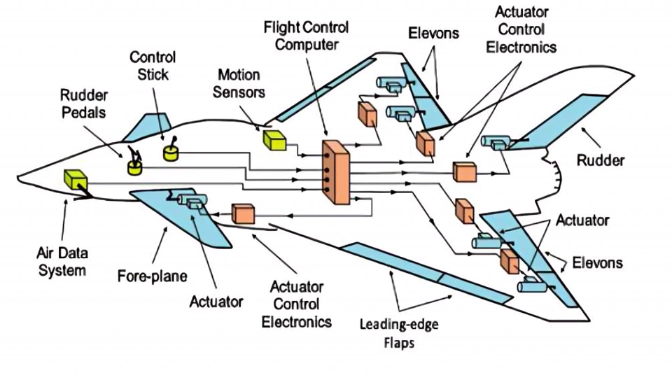

Mini Example: Flight Control System
Consider a simple flight control system.
Without ontology:
A model might show:
  • Sensor → Actuator
At first glance, this may appear reasonable in a diagram.
With ontology:
The system is defined with clear relationships:
  • Sensor provides data to Controller
  • Controller commands Actuator
This naturally leads to the structure:
  • Sensor → Controller → Actuator
Ontology helps ensure that system models are not only easy to create,
but also consistent, structured, and aligned with how the system is intended to work.
