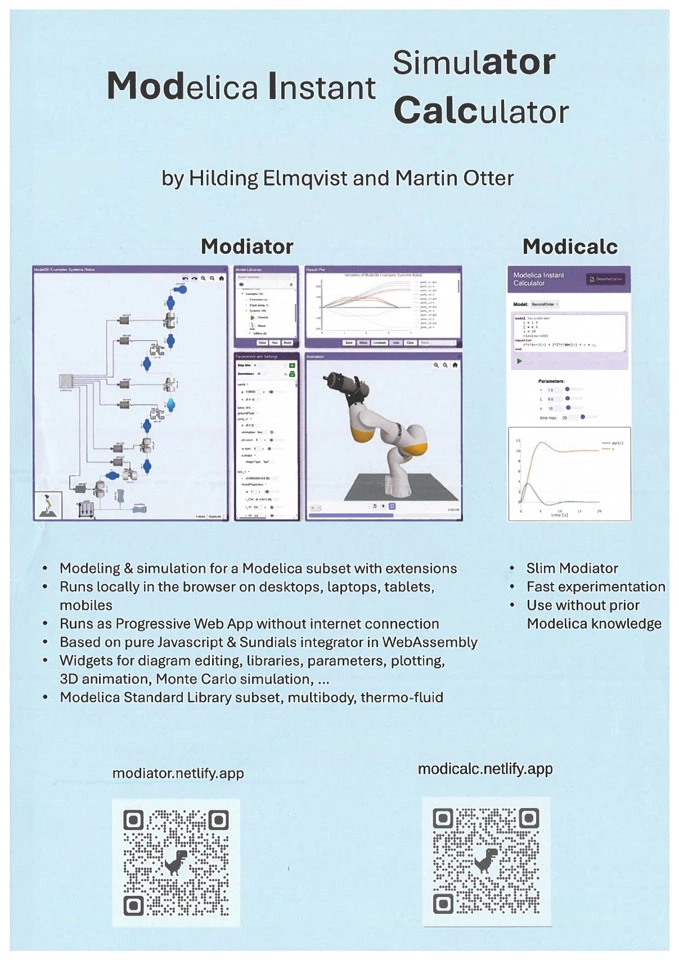

  • 'Curiosity' Modiator research tool : web app, for tablets, enables a quick discovering of modeling, could reach students, source : Hilding ElmqvistMartin Otter (Modelica founders & former chairman of the community )
Modiator app

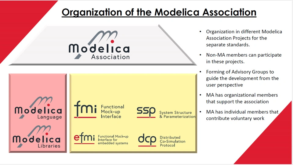

3. Modelica Association and community
Modelica Association organisation

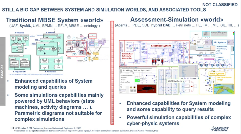

4.1 Systems Engineering (MBSE) and Modelica + standards are complementary
MBSE (architecture , sysML, and governance , processes etc …) & Systems ModSim (Modelica & related standards) are now seen complementary.
 This was illustrated by several industrial presentations, for instance by BOSCH, AVL, SAAB, Dassault Aviation, Airbus, DENSO.
Dassault Aviation - MBSE & Modelica/FMI

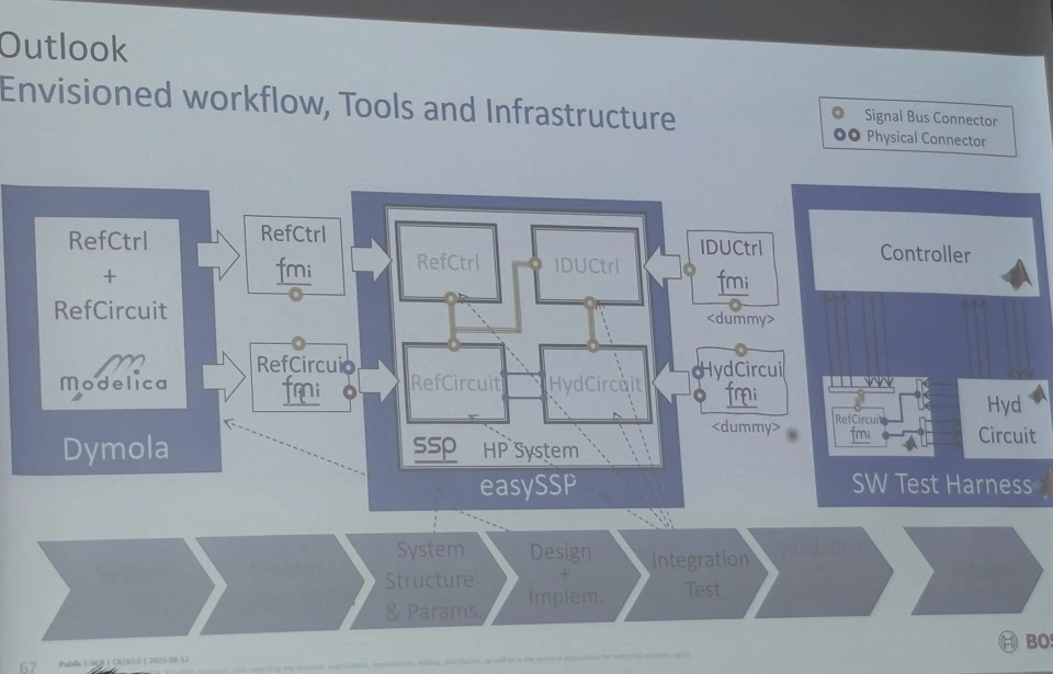

BOSCH Credible Process - Tools, standards, workflow
AVL + BOSCH - prostep IVIP for Smart SE

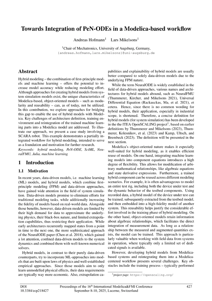

4.2 Articifial Intelligence is here
AI is visible with several presentations which is not surprising, but not so much.
But still the Modelica Conference focus remains mainly on the usuals themes : ie. Modelica language, libraries, standards, industry view
Physics Enhanced Neural ODEs - Uni AUgsburg
Towards Integration of PeN-ODEs in a Modelica-based workflow

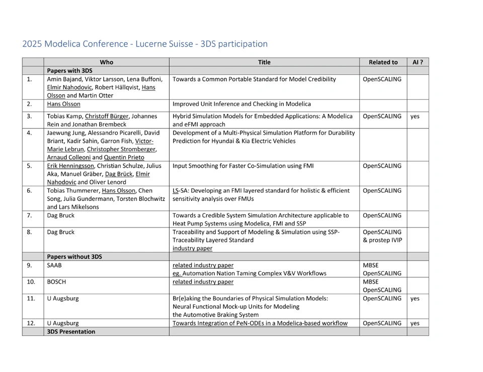

4.3 3DS participation
3DS contributed to a large content : tutorials, tool vendor session, technical papers and presentations, demonstrators.
List of 3DS presentations, tutorials, talks
