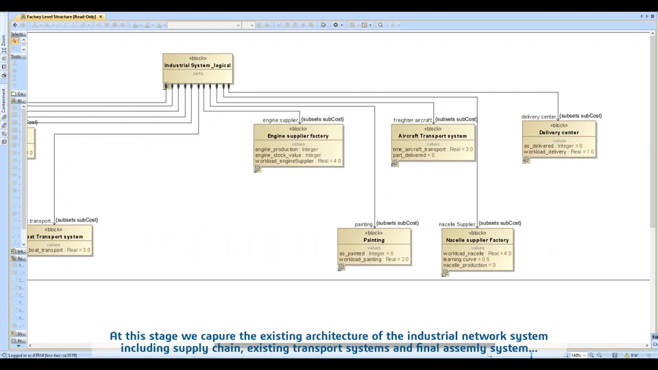

Following our MagicGrid methodology, we start with the Problem Domain by specifying high-level use cases and modeling the system structure and architecture of the industrial network system. 🛠️ Based on functional analyses and architecture definitions, we refine the input requirements into more specific ones for the industrial system—these refined requirements become the starting point for the Solution Domain.
In the Solution Domain, we start specifying the behavior of different subsystems within the industrial network system (e.g., transport systems, suppliers, final assembly system, etc.). The goal of this high-level behavior modeling is not to create detailed behavior models but to gain a preliminary understanding of key criteria such as production rate, lead time, and costs. Gaining this early insight into system behavior is essential for guiding the OEM's decision-making process for the new program.
At this stage, we can conduct various analyses to assess production rates, stock status, and overall system performance 📊 By analyzing the behavior of the existing supply chain, we can verify whether the current setup can meet the requirements of the new program. We take it further by developing alternative solutions for the subsystems of the industrial network system by changing transportation methods or altering time- and cost-related parameters for suppliers, creating a range of potential solutions for evaluation. By integrating these subsystem configurations, we build complete alternative solutions for the entire industrial network system, enabling us to identify the most effective option based on data-driven insights ✅

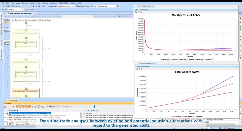

In our storyline, we now shift focus to the Final Assembly Line, which falls directly under the OEM’s responsibility. It’s worth emphasizing that at this stage, the behavior modeling of the FAL is not meant to be a detailed representation of every process step. Instead, the goal is to capture the system behavior in a way that allows OEM to evaluate it against key cost- and time-related criteria, such as production rate and lead time, which are critical for decision-making during the early stages of development 💡
Here, we will assess the performance of the existing assembly process, which uses 4 Automated Guided Vehicles (AGVs), to determine whether the current solution can meet the newly derived requirements for FAL in relation to the new program. From there, we will go a step further and begin developing alternative solutions, such as configurations using 6 or 8 AGVs🚛🤖 We will then conduct trade analyses to compare these potential alternatives with the current solution. By doing so, we can evaluate different solution scenarios and identify the most viable option, supporting the OEM in making informed decisions for the new setup of the FAL for the new program
