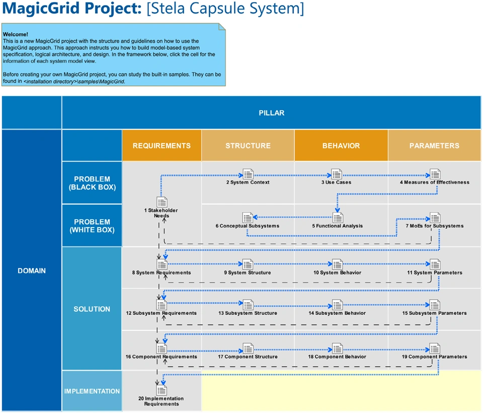

Figure 1. The structure of the highest order diagram for a Medical Delivery System (Stela).
The framework: a traceable engineering backbone
The framework starts with a classic systems engineering move: identify stakeholder needs across multiple departments, not only engineering. The paper explicitly includes R&D, engineering, finance, marketing, production, manufacturing, regulatory, and logistics perspectives. This is crucial in medical devices because safety, usability, manufacturability, business constraints, and regulatory evidence cannot be bolted on after the design has stabilized.
The authors structure the model using Magic Grid V2 in CATIA Magic Cyber Systems Engineer. The top-level architecture moves from stakeholder needs and system context into use cases, conceptual decomposition, functional analysis, requirements, parameters, implementation requirements, and verification. In other words, the model is intended to preserve line-of-sight from intent to evidence.

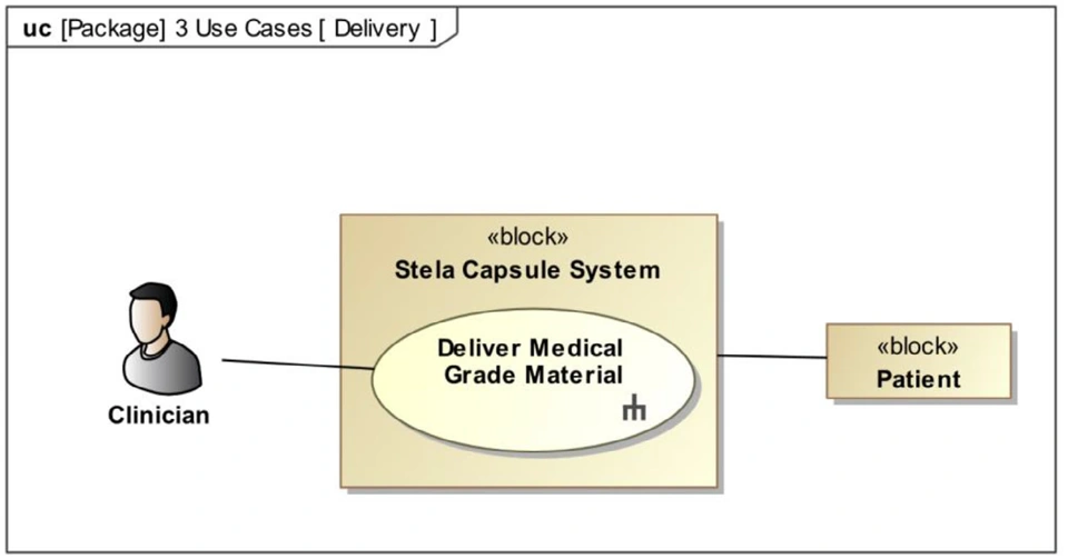

Figure 2. SysML use case diagram representing the primary system interaction for delivery of medical grade material.

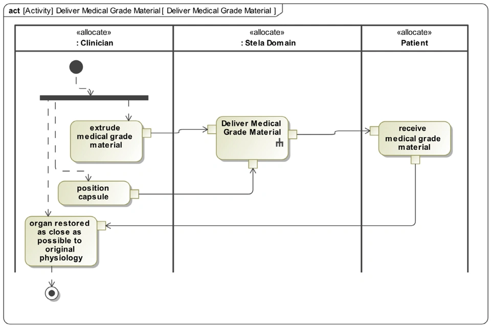

Figure 3. SysML activity diagram illustrating the sequence of actions and allocation of responsibilities across clinician, capsule system and patient during the delivery of medical grade material, from initial actuation through to material extrusion and clinical application.

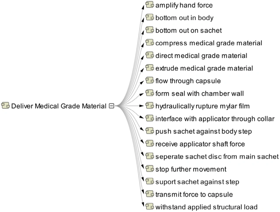

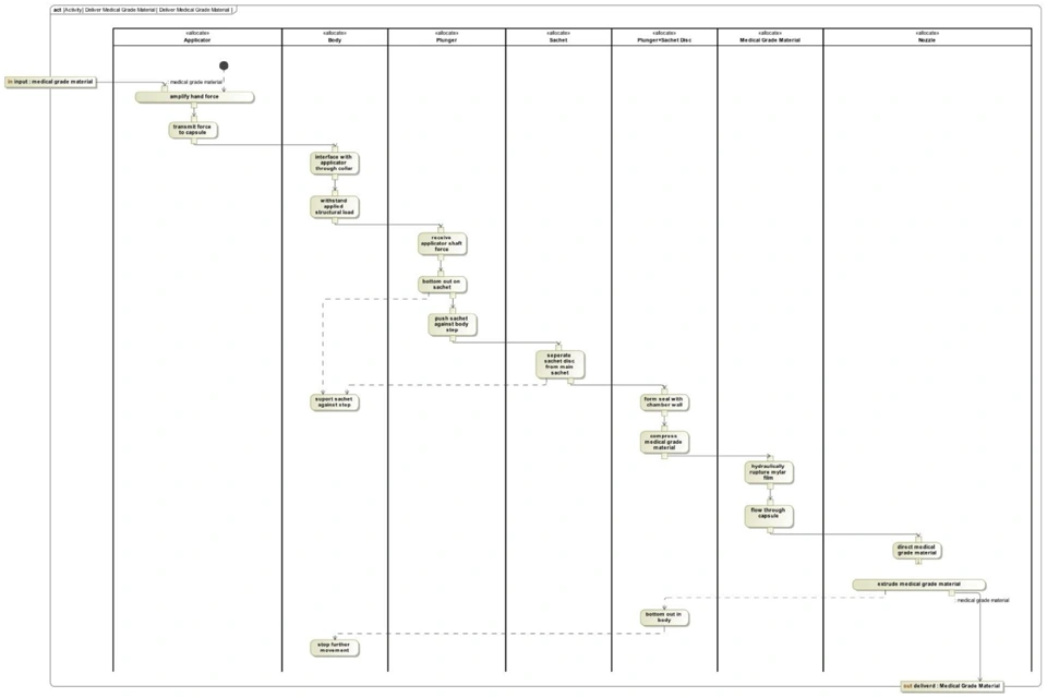

From use case to functions, requirements, and critical interfaces
The selected use case is controlled delivery of medical-grade material from a capsule system to a patient. On the surface, this sounds straightforward: the clinician actuates the device, the material moves through the capsule, and the patient receives the material. But the paper shows that this simple clinical scenario decomposes into several interacting physical behaviors.
Two domains dominate the use case: structural behavior and fluidic behavior. The structural domain governs whether the capsule body and nozzle interface can withstand the load without separation or leakage. The fluidic domain governs the pressure and flow behavior of the medical-grade material during extrusion.
For the validation use case, the authors deliberately scope the digital twin to the structural domain, especially the annular snap-fit interface between the body and nozzle. This is a good methodological choice: it keeps the demonstration focused while still tying the analysis back to clinically meaningful device performance.
Figure 4. Detailed SysML activity diagram illustrating functional allocation across physical subsystems and interfaces, capturing internal system interactions during delivery of medical grade material, with emphasis on force transmission, interface behavior and structural load resistance.
Figure 5. Traceable functional breakdown of the primary system function “Deliver Medical Grade Material” derived from the SysML activity model.

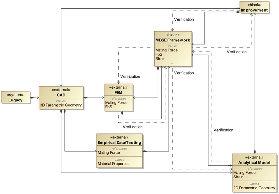

What makes the digital twin useful
The structural digital twin is not a continuously synchronized operational twin. The capsule does not contain embedded sensors. Instead, the paper implements an event-based design and verification twin: empirical data, material properties, CAD geometry, analytical calculations, finite element results, and verification outputs are connected through the MBSE framework.
This matters because many “digital twin” claims in engineering collapse into disconnected simulations. Here, the twin is valuable because each result is interpretable as model-based evidence against a requirement or measure of effectiveness. Mating force, peak strain, and factor of safety are not just simulation outputs; they are linked indicators of structural integrity for the clinical use case.
Figure 7. Implementation architecture of the structural digital twin within the MBSE framework, integrating CAD geometry, analytical modelling, FEM and empirical testing through the MBSE environment as a central coordination layer.

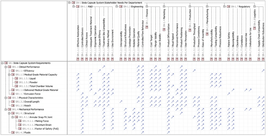

Figure 8. MBSE traceability matrix linking stakeholder needs to system requirements for the Stela capsule-based biomedical delivery system.

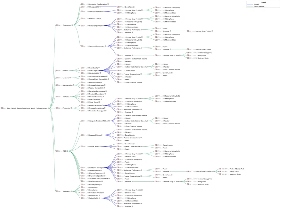

Figure 9. Hierarchical MBSE traceability diagram linking stakeholder needs to system, sub-system and implementation requirements for the Stela capsule-based biomedical delivery system.

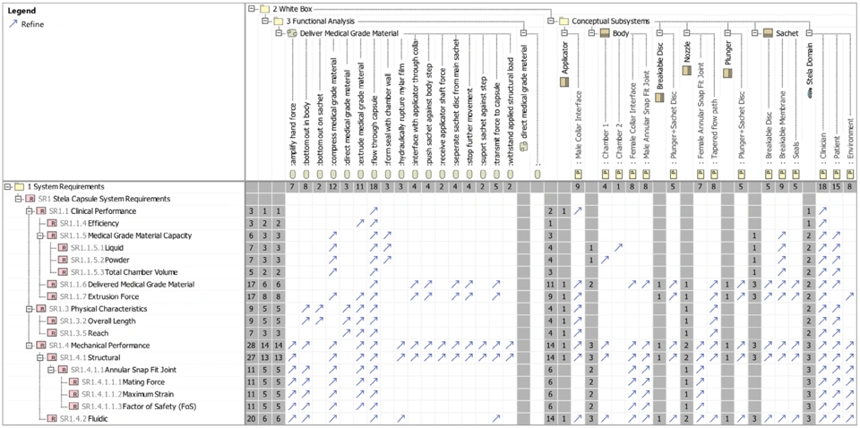

Figure 10. MBSE traceability matrix linking system requirements to sub-systems and components of the Stela capsule-based biomedical delivery system.

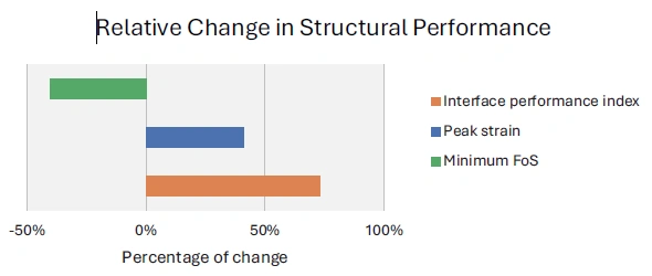

The structural result: better interface performance, controlled risk
The core engineering result is a roughly 70% improvement in structural interface performance compared with the baseline design. This was not achieved by simply making the design “stronger” in an unbounded way. Peak strain rose from 7.5% to 10%, and the minimum factor of safety dropped from about 2.0 to 1.2, which was the defined acceptance threshold.
That trade-off is important. It shows controlled use of the available mechanical envelope: higher mating performance, higher strain, lower reserve margin, but still within defined structural limits. From a systems engineering perspective, the design decision is defensible because the trade can be traced to requirements, analysis, and empirical validation.
Figure 11. Relative change in key structural performance metrics following improvement of the Stela capsule-based biomedical delivery system.

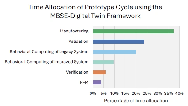

The development-speed result: faster loops, not magic
The paper compares the MBSE-digital twin workflow against a literature benchmark of about 19 weeks per prototype cycle. In the case study, the active measured workflow for manufacturing, verification, validation, modeling, and computation totaled about 30 hours. Manufacturing and validation remained the largest contributors, which is exactly what one would expect once digital work begins to compress the modeling and decision loops.
The authors are appropriately cautious: this is not a like-for-like elapsed-time prediction. The 19-week benchmark includes broader hardware-development realities, while the paper’s 30-hour workflow is active task time under specific assumptions. Still, the comparison is useful because it shows where a traceable digital twin workflow can compress iteration burden and shift effort earlier into analytical and computational decision-making.
Figure 12. Time allocation across the validated 3-week prototype cycle used in the MBSE-digital twin workflow.
