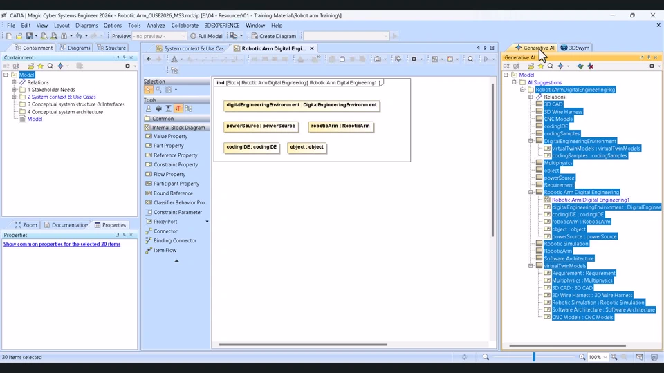

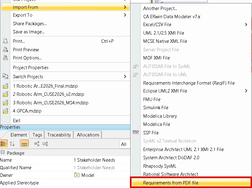

The extracted requirements are first placed in an AI sandbox, where they can be reviewed by the modeler. The modeler can then decide whether to take them over into the model, decline them, or selectively pick specific requirements.

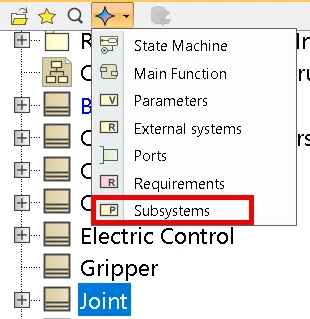

Model Suggestions gives the modeler the possibility to receive AI-augmented suggestions in an AI sandbox, based on the selected model elements.
For example, the modeler can select a system, defined as a Block, and receive suggestions for possible subsystems of that system. Triggering this option runs a predefined query, and the result is a list of newly generated elements in the AI sandbox.
The query behind each option is defined in a configuration file, JSON, located in the CATIA Magic installation folder.
Value: These predefined queries are customizable and can be extended to include specific rules or customer-specific methodologies. This helps ensure that the suggested model elements are aligned with user needs and modeling guidelines.
Model Suggestions are especially well suited for executing repetitive actions that do not require further input from the modeler.

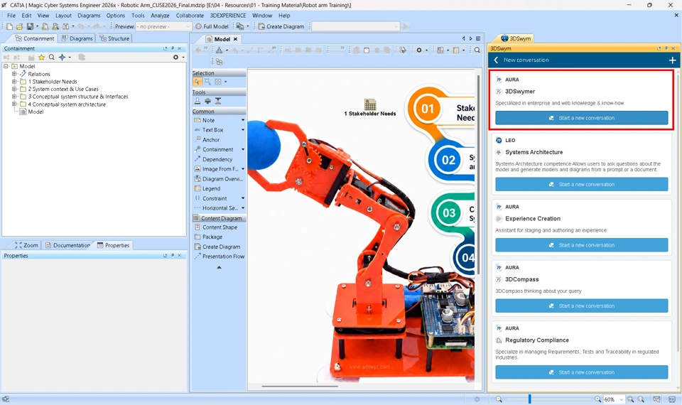

Virtual Companions (AURA and LEO Systems Architecture) in CATIA Magic
3DSwym is integrated into CATIA Magic, giving the modeler access to all available Virtual Companions and competences, including AURA.
Using AURA directly from CATIA Magic allows the modeler to ask generic questions, for example about tool documentation.
However, AURA does not have access to the model itself. Therefore, it cannot answer questions in the context of the current model or generate model elements directly.

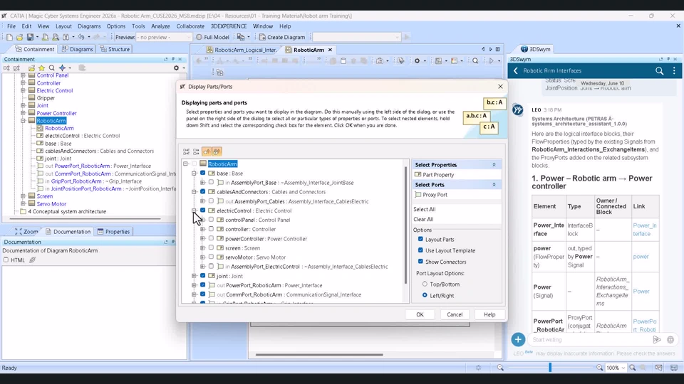

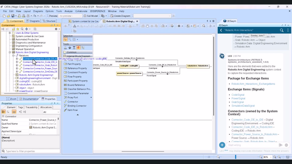

- Reference already existing model elements when creating new ones. For example, it can create a connector between an existing system and a newly generated one, even within a single call that also generates the new system.
- Provide a detailed report, including hyperlinks to existing elements in the model tree.

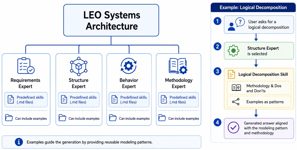

How does LEO work and make decisions?
LEO Systems Architecture has access to different so-called “Experts”. These are categorized as Requirements, Structure, Behavior, and Methodology Experts.
Each expert has a set of predefined skills, provided as .md files. Each skill can also include examples, which are JSON files of well-designed SysML models.
For example, a skill for logical decomposition can include an example of a well-defined logical decomposition of a system. Each time the user asks for a logical decomposition, this example can be used as a pattern. As a result, the generated answer is better aligned with the provided modeling pattern and methodology.

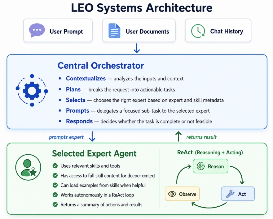

Which expert is used for a specific call is decided by a central orchestrator. The orchestrator receives the user prompt together with additional context, such as user-provided documents and the chat history. It analyzes the request and routes it to the most suitable expert, for example the Structure Expert or the Behavior Expert. The selected expert then uses its dedicated skills in a ReAct (Reasoning + Acting) loop until the task is completed.

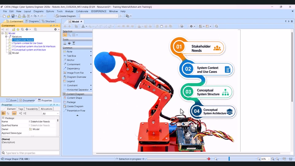

| Step 1: Create package structure (LEO) | Generating packages based on given prompt |
| Step 2: Import Requirements | Importing requirements based on a requirement table documented in PDF | |

Step 6: Create the System Structure of robotic Arm based on imported picture (LEO) |
