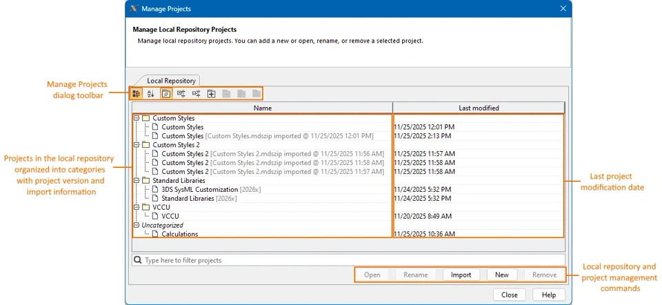

Local Project Management Improvements
The Manage Projects Dialog Simplification
The Manage Projects dialog has been improved by removing redundant buttons and reducing the number of displayed columns. Project version and import details are now displayed within the Name column. These enhancements deliver a cleaner, more intuitive interface and a smoother project-management experience within the local repository.
Project Naming Improvements in the Local Repository
Updates have been introduced to project naming in the local repository. Updates have been introduced to project naming in the local repository.
  • Projects created in the local repository are now displayed only by their project name.
  • Imported projects are displayed using the following structure: [.mdszip imported @].
This update provides more precise and informative details at a glance.

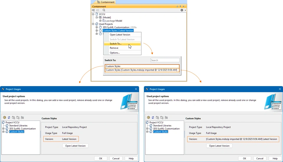

Improved Workflow for Updating Used Projects
The workflow for updating used project versions has been redesigned. In the main project, an outdated used project may refer to two of its available versions: Older Version or Latest Version. You can choose to update the used project to its latest version via the Switch to Latest Version command or continue using the older one. This simplified workflow makes updating used projects faster, clearer, and more efficient.
Improved Workflow for Switching Between the Original Used Project and Its Subsequent Imports
You can now easily switch between the original used project and its subsequent imports via the Switch To command.
  • The Switch To menu displays the used project originally created in the local repository by indicating the project name and version (Latest/Oldest Version).
  • Subsequent imports of the project are displayed using the structure: <[.mdszip imported @] >.
This new workflow separates switching between imports from updating to the latest version, offering a clearer and more intuitive experience.
