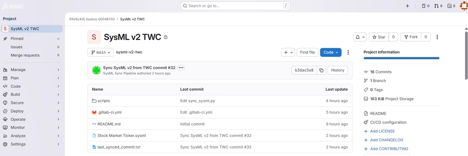

Figure: GitLab — Repository showing exported sysml file, python script which used REST API to get sysml file, and pipeline configuration file automating process.
Figure: GitLab — Repository showing updated .sysml file and commit history

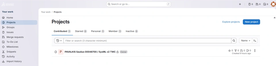

STEP 1  Create the GitLab Project
Create a new project in GitLab to store the exported SysML v2 files. This repository will serve as the version-controlled archive of your model.
1.1 Navigate to your GitLab instance and click New Project.
1.2 Choose "Create blank project" and fill in:
Setting
Value
Project name
sysml-v2-twc
Visibility
Private (recommended)
Initialize with README
Yes
1.3 Click Create project. Note the Project ID shown on the project page (e.g., 9128).

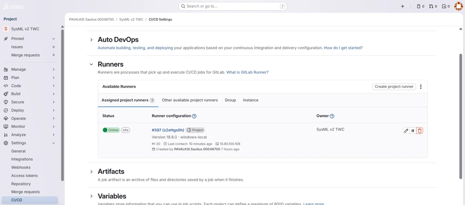

STEP 2  Install & Register the GitLab Runner
A self-hosted GitLab Runner is required because the TWC server is on an internal corporate network that cloud-based runners cannot reach. The runner must be installed on a Windows machine with network access to both TWC and GitLab.
2.1 Download the GitLab Runner binary for Windows from the GitLab documentation site.
2.2 Create a directory for the runner:
mkdir C:\\GitLab-Runner
2.3 Place the downloaded executable as gitlab-runner.exe in that directory.
2.4 In GitLab, go to your project: Settings → CI/CD → Runners → Expand. Click "New project runner" and note the registration token.
Figure: GitLab — Runner registration settings page
2.5 Open PowerShell as Administrator and register the runner:
cd C:\\GitLab-Runner
.\\gitlab-runner.exe register
# When prompted, enter:
#  GitLab URL:      https:// name>
#  Registration token:
#  Description:
#  Tags:            shell, windows
#   Executor:        shell
2.6 Install and start the runner as a Windows service:
.\\gitlab-runner.exe install
.\\gitlab-runner.exe start
.\\gitlab-runner.exe status   # Should show: running
Shell Executor
The shell executor runs CI jobs using PowerShell (pwsh) directly on the Windows host. This avoids Docker overhead and gives the pipeline native access to Python and git, both of which must be pre-installed on the machine.

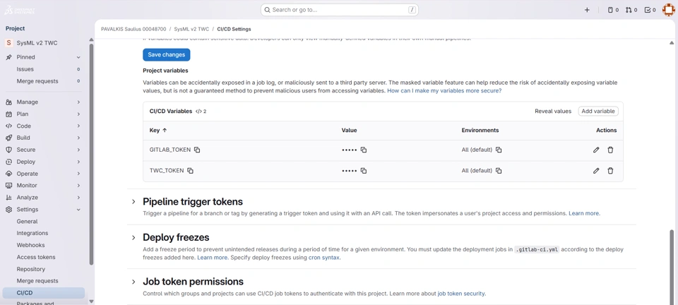

STEP 3  Configure CI/CD Variables
The pipeline script requires authentication tokens to access both TWC and GitLab APIs. These are stored securely as masked CI/CD variables.
3.1 Go to your GitLab project: Settings → CI/CD → Variables → Expand.
3.2 Add the following variables:
Variable
Description
TWC_TOKEN
JWT token from Teamwork Cloud (personal access token)
GITLAB_TOKEN
GitLab personal access token with api + write_repository scope
Important: Uncheck "Protected"
Both variables must have the "Protected" checkbox unchecked. Protected variables are only available on protected branches and will not be passed to pipelines triggered by webhooks (trigger source). This is the most common cause of 401 authentication errors.
Figure: GitLab — CI/CD Variables configuration with Protected unchecked

8. Repository Structure
After setup, the repository should have this structure:
sysml-v2-twc/
├── .gitlab-ci.yml                 # Pipeline configuration
├── scripts/
│  └── sync_sysml.py              # TWC sync script
├── Stock Market Ticker.sysml      # Auto-generated SysML export
├── last_synced_commit.txt         # Tracks last synced TWC commit
└── README.md

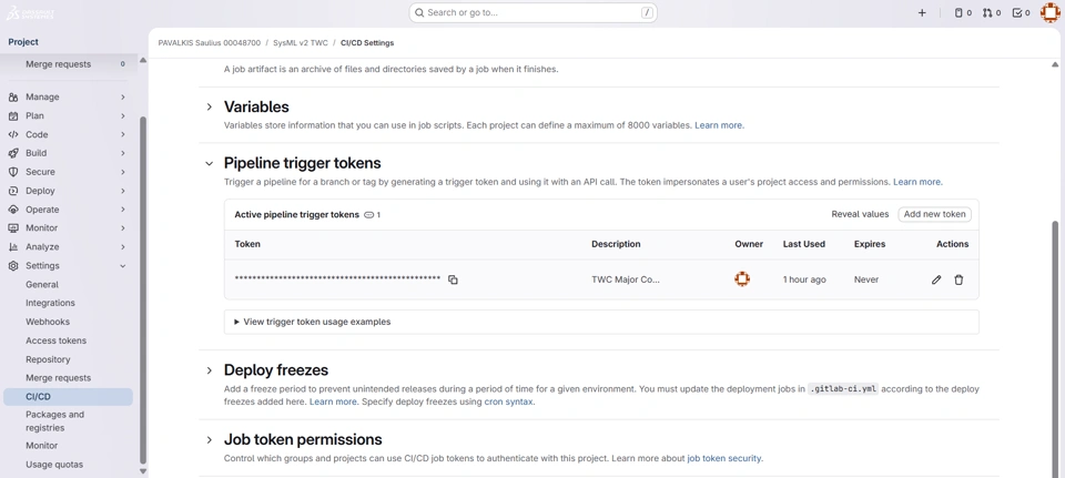

STEP 5  Create a Pipeline Trigger Token
A pipeline trigger token allows external systems (like TWC) to start pipelines via an HTTP POST request.
5.1 In GitLab, go to: Settings → CI/CD → Pipeline trigger tokens → Expand.
5.2 Click "Add new token" and provide a description (e.g., "TWC Webhook Trigger").
5.3 Copy the generated token. It will look like: glptt-xxxxxxxxxxxxxxxxxxxx
Figure: GitLab — Pipeline trigger token creation
5.4 Test the trigger from PowerShell:
# Bypass SSL certificate validation for self-signed certs
[System.Net.ServicePointManager]::ServerCertificateValidationCallback = {\\\$true}
Invoke-RestMethod -Method POST `
 -Uri "https://api/v4/projects/9128/trigger/pipeline" `
  -Body @{token="glptt-xxxxxxxxxxxxxxxxxxxx"; ref="main"}
If successful, the response will contain a pipeline ID and status "created".

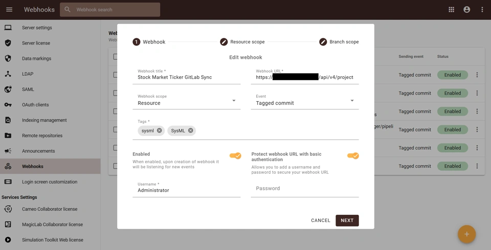

STEP 6  Configure the TWC Webhook
The final piece connects TWC to GitLab by configuring a webhook that fires when a tagged commit is created.
6.1 Open the Teamwork Cloud administration panel (typically at https://your-twc-server:8443/admin).
6.2 Navigate to: Webhooks → Add webhook.
6.3 Configure the webhook with the following settings:
Setting
Value
URL
https:// server>/api/v4/projects/9128/trigger/pipeline?token=glptt-xxx&ref=main
Scope
Resource (select your SysML project)
Event
Tagged commit
Tags
Major, major
Enabled
Yes (checked)
Figure: Teamwork Cloud — Webhook configuration panel
6.4 The webhook URL includes the pipeline trigger token and branch reference as query parameters. When TWC fires the webhook, it sends a POST to this URL, which GitLab interprets as a pipeline trigger.

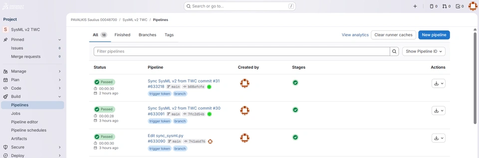

STEP 7  Test the End-to-End Flow
With all components configured, test the complete automation:
7.1 Open your SysML v2 project in CATIA Magic.
7.2 Make a change to the model (e.g., update a requirement text).
7.3 Commit the change to Teamwork Cloud and apply the "Major" tag.
7.4 Check GitLab → Build → Pipelines. A new pipeline should appear within seconds.
Figure: GitLab — Pipeline running after TWC webhook trigger

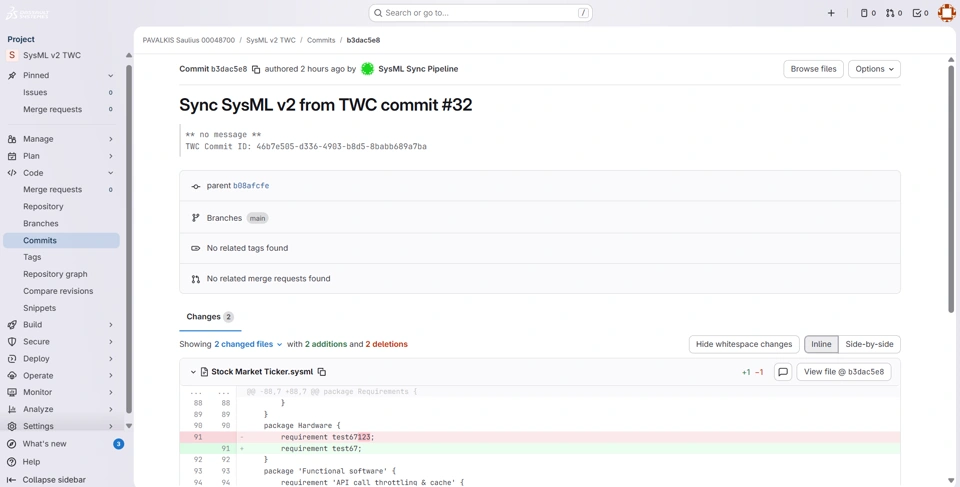

7.5 Once the pipeline completes, verify:
  •  The .sysml file in the repository is updated with the latest model content.
  •  The last_synced_commit.txt contains the TWC commit ID.
  •  A downloadable .sysml artifact is available on the job page.
