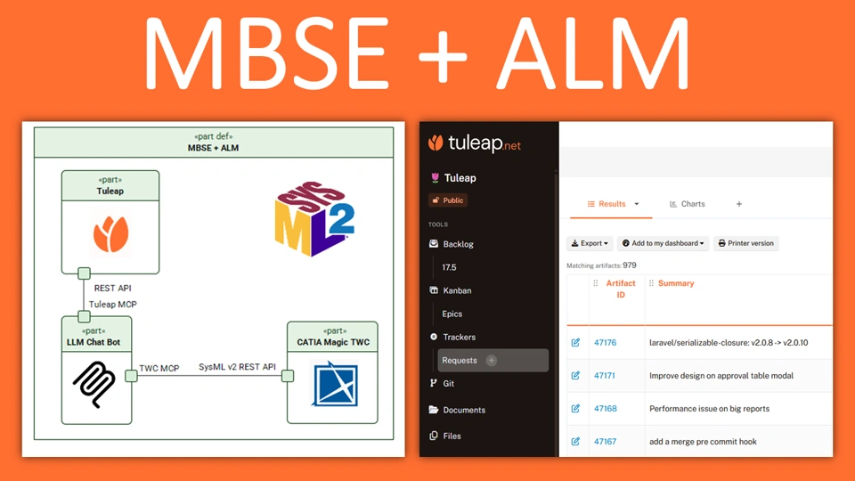

Tuleap and CATIA Magic MCP based integration archtiecture

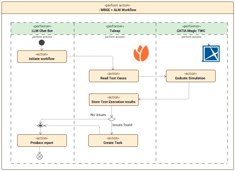

Integration worflow
