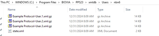

Note: If you would like to retain all the versions of a protocol, then move the files from the user’s folder to the location of your interest and then rebuild the index using ‘dbutil’ for that folder after moving (
