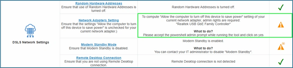

Changes in Network Adapter Setting Check
As part of the recent fix, the Network Adapter power-saving setting check has been updated.

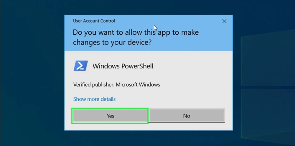

Due to recent Windows security and policy updates, checking the setting “Allow the computer to turn off this device to save power” now requires administrator (admin) privileges.
What will users see?
While running the tool, a Windows PowerShell admin prompt will appear asking for permission to make changes to the device.
What needs to be done?

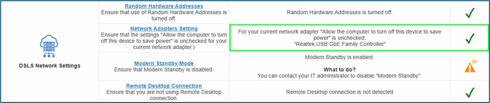

Users must click “Yes” on the admin prompt to allow the tool to correctly compute and validate the network adapter setting, as shown below:
If users select “No” then user will see the below warning:

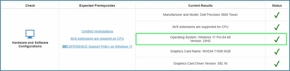

Operating System:
Windows 11 supported levels for 3DEXPERIENCE® Platform on the Cloud are as per below:
Windows 11 Enterprise: Supported versions are 23H2 and 24H2
Windows 11 Pro: Supported versions are 24H2
Windows 11 Pro for Workstations: Supported versions are 24H2
For more details on the same, please refer below support policy:

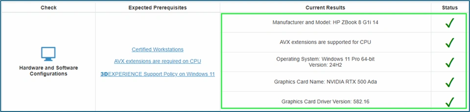

Cloud Eligibility Checker does take these changes into account in Hardware and Software Configurations check as per below:
New Certified Workstations:
In recent times, multiple workstations has been certified by the Dassault Systèmes for supporting the 3DEXPERIENCE® Platform on the Cloud. All of these workstations are updated into Certified Workstations List for 3DEXPERIENCE® Platform on the Cloud and the Cloud Eligibility Checker tool does take these changes into account in Hardware and Software Configurations check as per below:

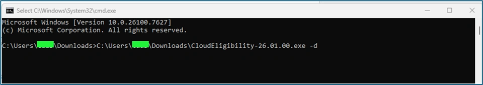

Good news! Logs are now available directly within the downloaded ZIP file, enabling single-click downloading of HTML and logs together. Earlier, logs need to be added separately in the zip file, but that’s now streamlined into one simple step.
If user need full logs, then they still need to use -d option while executing the Cloud Eligibility Checker Tool, as shown below:
