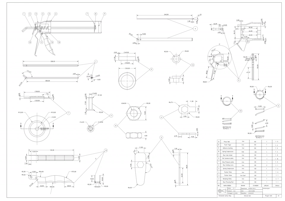

I would like to share my Semester 3 project, which focuses on recreating an existing product into a 3D design using SolidWorks. The object selected for this project is a silicone gun.
The purpose of this project is to improve my skills in reverse engineering and 3D modeling, by carefully observing the real product and translating its shape, dimensions, and components into an accurate 3D model. The design process involved analyzing the structure of the silicone gun, modeling each part in SolidWorks, and assembling the components to represent the original product.
Through this project, I gained a better understanding of mechanical design, part modeling, and assembly techniques, as well as how SolidWorks can be used to transform real-world objects into precise digital designs.
Below is the 3D design of the silicone gun created as part of my Semester 3 project.
