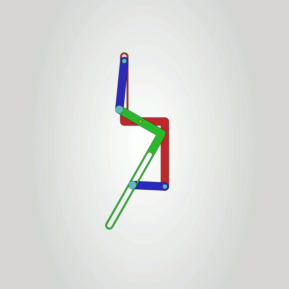

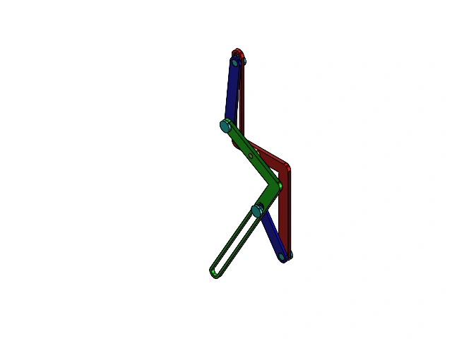

Welcome back to Motion Monday! This time for real 😁 , Recently I saw an interesting kinematic combination — the inverted slider crank in series with a slider crank — and thought of sharing a quick note on it.
It is basically a combination of two mechanisms connected one after the other.
  • A slider crank mechanism converts rotary motion into reciprocating motion.
  • An inverted slider crank mechanism is a variation where the slider is fixed and another link produces oscillatory motion.
  • When connected in series, the rotary output of the first mechanism drives the oscillatory motion in second, giving a modified and more controlled motion.
In this mechanism, there are 4 rigid links, 3 lower pairs (surface contact), and 2 higher pairs (point or line contact).
Using Gruebler’s equation for planar mechanisms:
DOF=3(n−1)−2L−H
DOF=3(n−1)−2L−H
where
  • n = number of links
  • L = number of lower pairs
  • H = number of higher pairs
Substituting the values:
DOF=3(4−1)−2(3)−2
DOF=9−6−2
DOF=1
This means the mechanism has one degree of freedom, and its motion can be completely controlled by a single input, i.e. the rotation of the crank.
Motion transformation in the mechanism:
  • Input: Rotary motion (360 Degrees, 100 rpm)
  • Intermediate: Oscillatory motion (angular displacement θ=61.78 degrees)
  • Output: Reciprocating motion (slider displacement 154.5mm)
