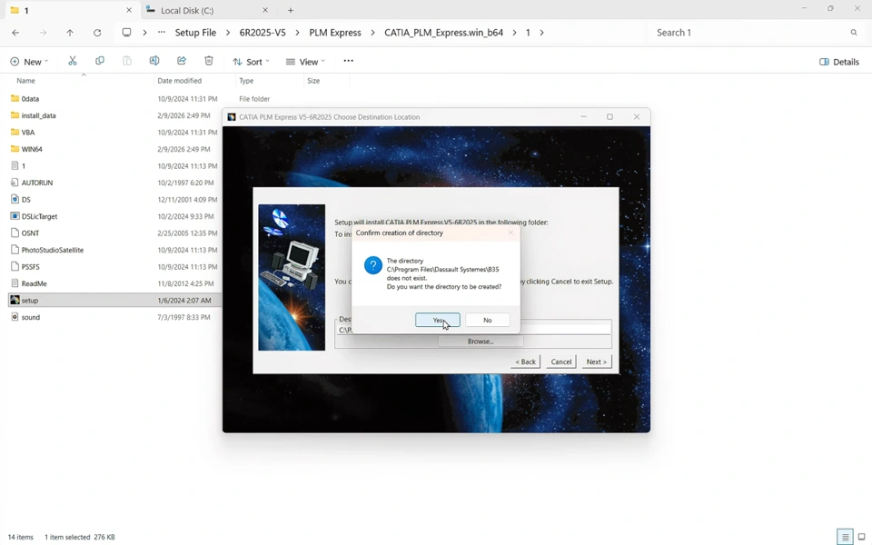

When you open the extracted folder, you will see a folder named “1”. Inside this folder, you can see the Setup exe. We right-click on Setup with the mouse and “Run as Administrator”. We proceed through the installation steps without changing anything. It is beneficial not to change the installation location. After the location selection screen, a popup like the one in the image will appear. You must continue the installation by clicking Yes to the question asking if you want the folders for the specified path to be created. If you are installing for the first time, you may see the creation of the CATIA Environment directory path in the next step. Continue the installation by clicking Yes to this as well, as shown in the warning below.
