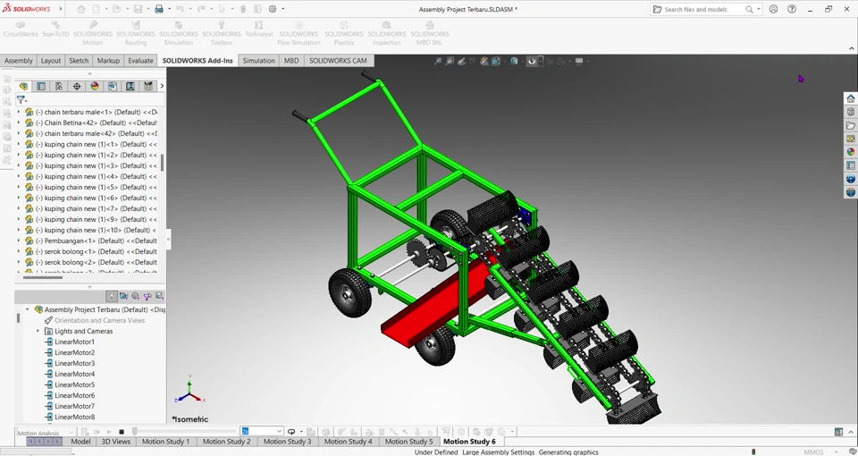

  1. Kinetic-to-Rotational Transmission: We designed a system that converts simple pushing force into high-torque digging power through a precision gear ratio connected to the wheels.
  2. Continuous Bucket Digging: The machine features 10 specialized buckets attached to a chain-driven system for non-stop sediment removal.
  3. Smart Perforated Design: Each bucket is designed with fine-perforated holes to ensure mud and trash are collected while allowing water to stay in the ditch, reducing the load.
  4. Variable Depth Adjustment: To accommodate different ditch sizes, the digging mechanism is fully adjustable up to a maximum depth of 80 cm.

We utilized the 3DEXPERIENCE platform and SolidWorks to validate every aspect of the machine:

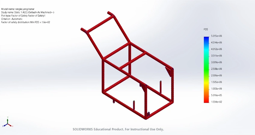

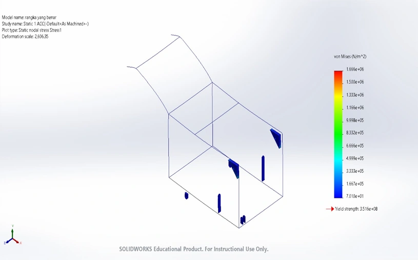

  • FEA Simulation: Stress analysis was performed on the main frame to confirm structural integrity and a high Factor of Safety.
