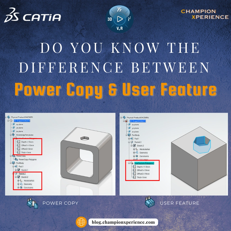

Power Copy:
A Power Copy is like an intelligent copy/paste. When you insert a Power Copy:
  • All features are fully visible and editable in the specification tree.
  • You can modify sketches, constraints, parameters, and more after insertion.
  • There is no permanent link to the original template, so each instance is independent.
Use Case:
Imagine you create a polygon pocket you want to reuse on many solids but still want to edit the sketches and parameters individually later. Power Copy is perfect here.
Note: If you change the original template during definition, CATIA can update inputs automatically. But after creation, each Power Copy instance stands alone.
User Feature: Your Custom, Protected Feature
A User Feature is a more advanced, “locked-down” template:
  • It appears as a single feature in the tree.
  • Internal construction features are hidden, so users can’t accidentally modify them.
  • Only published parameters and inputs are visible for editing.
  • Acts like a custom CATIA feature with strong design control.
Use Case:
You design a parametric polygon cut with multiple sketches and formulas. You want your team to reuse it but prevent them from changing the internal logic. A User Feature fits this need.
This protection is why many companies use User Features to enforce design standards and maintain consistency.

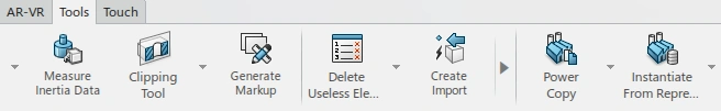

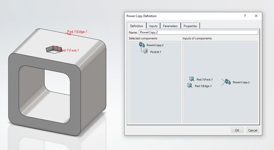

How to Create a Power Copy (Quick Steps)
  1. Open the part containing the geometry to reuse.
  2. Go to Tools → Power Copy.
  3. Name your Power Copy (e.g., PowerCopy-Polygon).
  4. Select features to include (e.g., the pocket).
  5. Use tabs to manage definition, inputs, parameters, and properties like icons or screenshots.
  6. Validate and save.

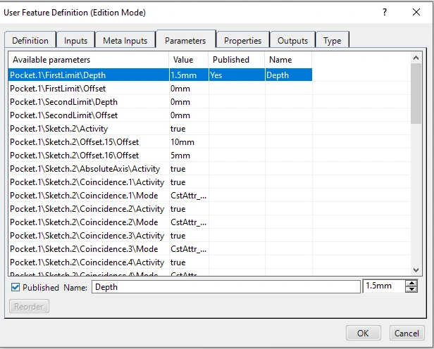

How to Create a User Feature (Quick Steps)
  1. Open the part with your geometry.
  2. Go to Tools → User Feature.
  3. Name your feature (e.g., UserFeature-Polygon).
  4. Select components and inputs, similar to Power Copy.
  5. Publish parameters for editing by users.
  6. Save your User Feature into the database.

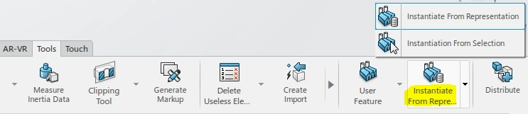

How to Instantiate a User Feature
There are two ways to insert a User Feature:
  • From a Representation (Library):
    Open a new part → Tools → Instantiate from Representation → Select your feature → Pick inputs → Preview & confirm.
  • From Selection (Session):
    Select the User Feature in the current session’s tree → Choose inputs → Validate.
Power Copy vs User Feature — Quick Summary
FeaturePower CopyUser Feature
Tree Visibility Shows all internal featuresShows single “UF” feature
Editable After Insertion Fully editableInternal parts hidden
Best For FlexibilityProtected, standardized
Use in Catalogs SupportedSupported
Knowledgeware Integration GoodVery strong
Intellectual Property (IP) Protection LowHigh
