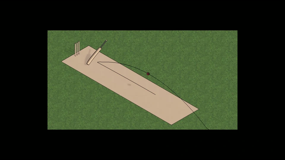

For this challenge, I tried to explore that moment using SOLIDWORKS by combining modeling, motion analysis, CFD simulation, and rendering.
I started by designing a 3D model of a cricket bat and ball, and then created a motion study to simulate the ball traveling across the pitch toward the bat. This helped visualize the trajectory, speed, and interaction between the bat and ball in a controlled environment.

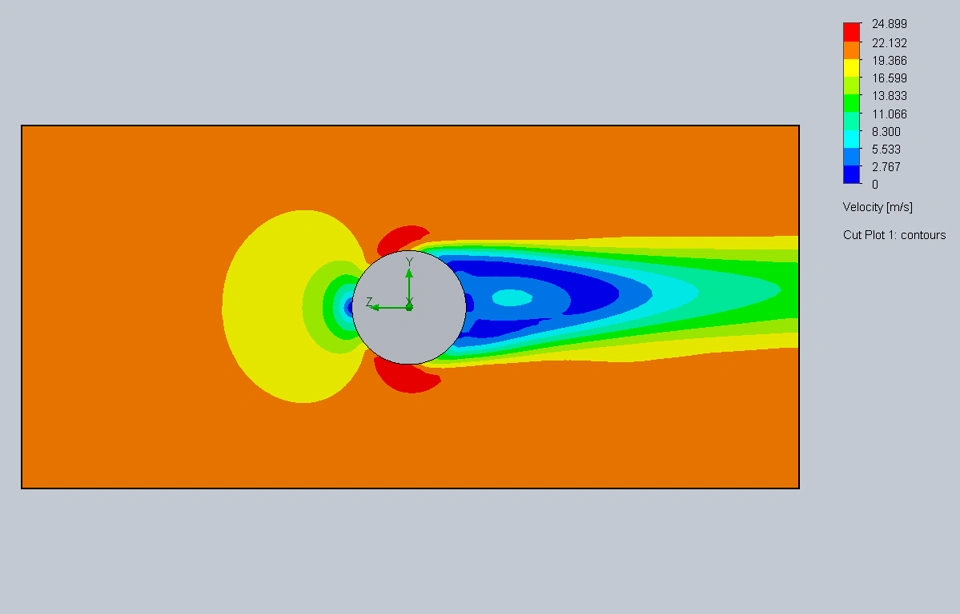

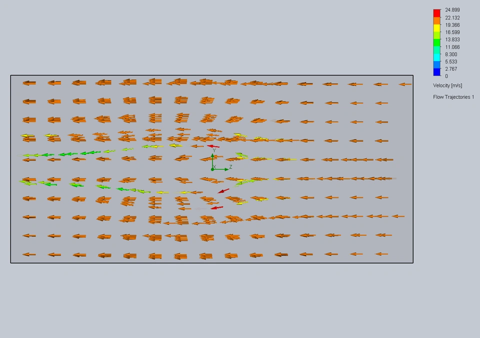

So I ran a CFD simulation with an incoming airflow velocity of around 25 m/s. Looking at the velocity contours and flow trajectories, a few interesting aerodynamic effects appear:
• At the front of the ball, the airflow slows down significantly, creating a stagnation region where the (Air Flow) velocity drops to about 0.6 m/s.
• As the air moves along the curved surface, it accelerates, reaching velocities of around 24.6 m/s.
• Toward the back of the ball, the flow begins to separate due to pressure changes, creating a wake region with much lower velocity.
• This wake also shows small recirculation zones, which contribute to the drag acting on the ball.
Seeing these patterns visually was really interesting because it turns something we normally take for granted into a clear engineering problem involving fluid flow, velocity gradients, and pressure differences.
