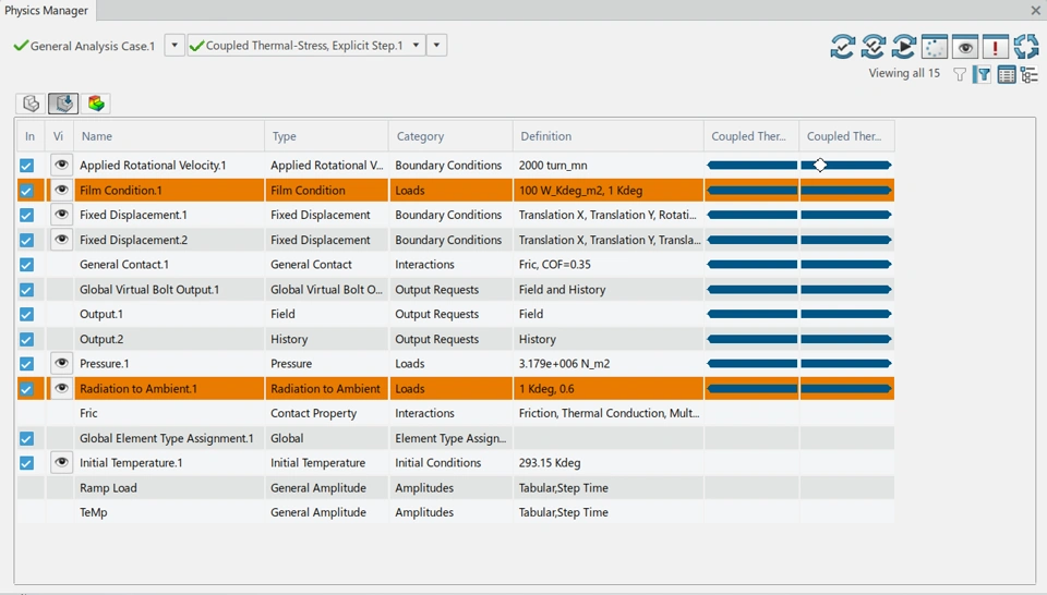

Physics Manager:-

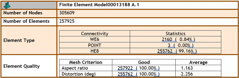

Mesh Properties:-

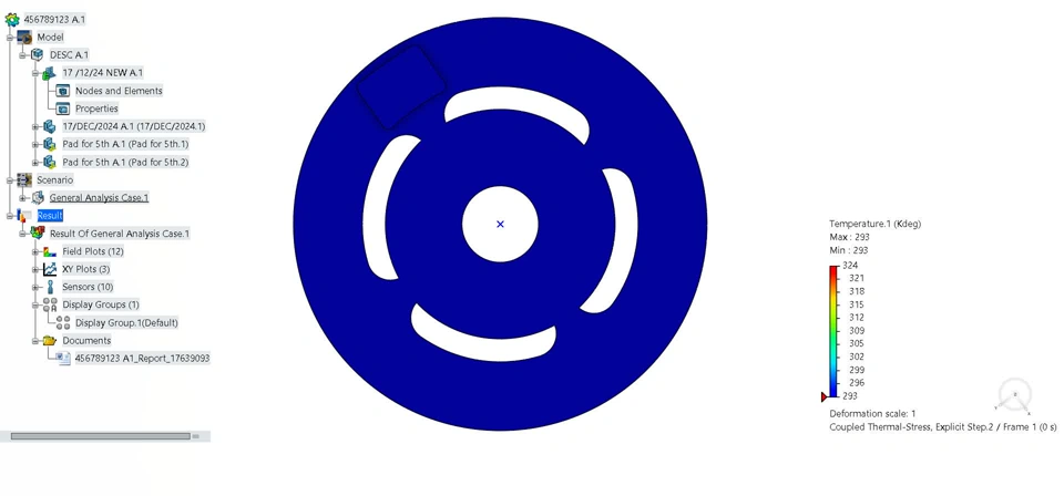

Result:-
Von Mises Stress:-
The Von-Mises Stress around the the rotor is 3.39x10^9 N/m^2 which is too high and unacceptable but the rotor has been made intentionally but the stresses generated on rotor is 5.88x10^8 which is 588 MPa which is under safe limit.
Conclusion:-
The coupled thermal–stress analysis of the brake disc shows that the maximum Von Mises stress reaches 5.88 × 10⁸ N/m² (588 MPa). When compared with the mechanical properties of hardened SS410 at 36 HRC, which provides an ultimate tensile strength of approximately 1100–1200 MPa and a yield strength of 850–950 MPa, the results indicate that the disc operates safely within the material’s strength limits. The stresses remain below both the yield and ultimate values, confirming that no permanent deformation or structural failure is expected under the evaluated braking conditions. Overall, the analysis validates the suitability of hardened SS410 for the brake disc design and demonstrates that the disc can withstand the combined thermal and mechanical loads effectively.
