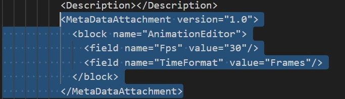

- Along the document, 4 out of 52 Animations will contain a block at the very end with a field "Fps" and the value "30". Why only 4 of the animations contain this? How can the file contain mixed information such as FPS 25 at one point and FPS 30 at another? How come this is a MetaDataAttachment if the animation contains no MetaData whatsoever?
- Of the 4 that contain such block, 1 of them has an additional field called "TimeFormat" and value "Frames". Again, why this inconsistency?
